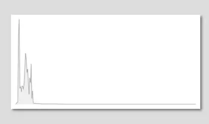

There's almost no data in the shadows and almost none in the bright highlights. Going the opposite way, here's one by a certain photographer whose work you're very familiar with. It's a low key image, also very well done.
But again, if you were to only use the histogram to gauge the exposure. this would have ended up in the trash. That's when the Qualitative Metrics come in.
