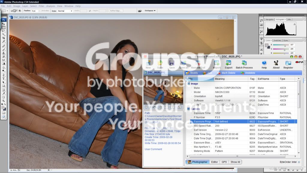

How can they tell what mode you're shooting in?
My exif says "not defined" :lol:
