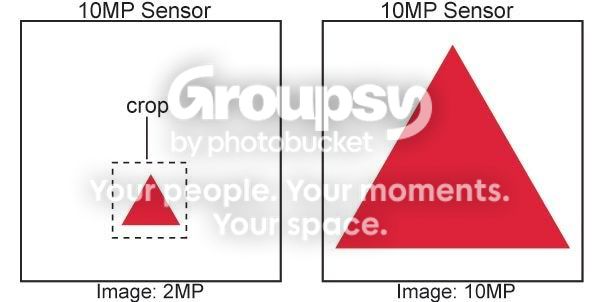

Got something to say? If cropping degrades an image then I guess all DSLRs that have a crop factor degrade the image....
That is completely wrong.
Cropping in photoshop degrades the image because it is like the old "digital zoom" function of point & shoot cameras. Every crop you make "effectively" reduces the "megapixels" of your photograph (I know, purists, that this isn't the right terms to use but I am trying to make sense of this for Prodigy).
Basically, when you crop digitally in PS, you are "effectively" reducing your 10mp camera to a 6mp camera, or a 4mp camera or even less.
The crop factor built into the camera does not do that at all. It is 100 percent of the resolution of the sensor. All it does is (again, effectively if not actually) add focal length to your lenses. It in no way affects the image quality good or bad, unlike "digital cropping".

This is exactly what I addressed in my post.
You crop in Photoshop, and you're throwing away pixels. You crop in the camera, and your image fills the sensor and gives maximum detail. How is that difficult to understand?

usayit, as you know cropping doesnt degrade the image, only if you keep the same size... take a 8x10 and scan it...crop it and re=print as 8x10 then yes there will be degrading....
Which is exactly why your idea of PS cropping will not work. For the most part, people don't just crop... they crop and enlarge too fill space. That in turns degrades the image.
Most of the time, cropping (without enlarging) is done at print. To show case a particular print in gallery frame. If we are talking PS, that isn't what we are talking about.
