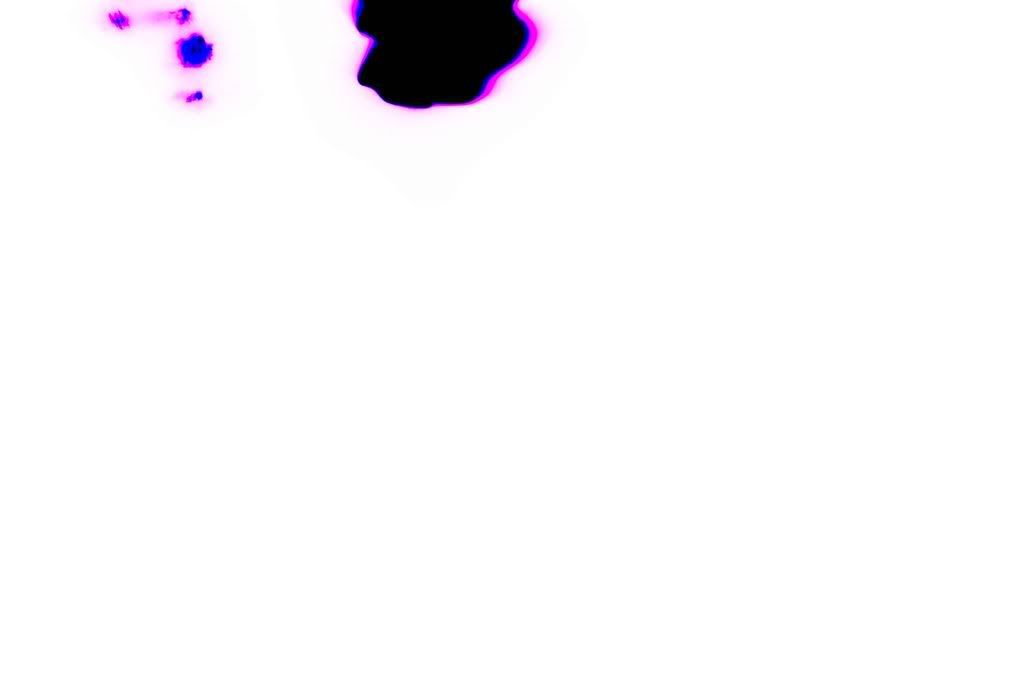

next thing i did was some test shots. without a lens mounted, i get this (little scary):
this doesn't look like the result of mold. it looks like a supernova of pixels. dead and dying. eek.

it actually does look a lot like mould. Mould is basically microscopic...so it can really grow anywhere. I'd send it to Nikon.

Bad pixels would probably manifest themselves as very discreet, sharp distortions that would be obvious as heck in any photo. That amorphous shape and the modest effect it is having on photos at this point definitely looks like mold.
There is normally a spacer and a very thin layer of air between the sensor and the hotmirror in front of it (the sensor is a delicate silicon chip, if the glass hotmirror contacted it it would probably cause significant damage.)
I'm sure Nikon could fix it if you sent it in, but the cost of a new hotmirror, sensor, and labor wouldn't really make it worth it for the camera probably considering the price you could find a decent used one for most likely.
