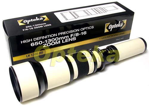

Someone is trying to sell it to me
I think we can't see it as the image is being linked from inside your googlemail account - and since that is a private and passworded area for you alone the image won't link out.
no, if it was $2 it might be a good purchase, to use as a door stop
I would pay $10 just to break it........
To give an idea the base lens is 650mm long with an f stop of f8 - and that is fixed, so you can neither open it up wider nor stop it down further should you so desire. That makes it a slow lens at 650mm long.
It gets to the 1300mm by adding a 2*Teleconverter which doubles its focal length, takes away 2 stops of light (so now f16) and significantly reduces image quality.
The base lens itself is little more than a long distance landscape lens at f8 and its overall optical quality is very poor. The 2*TC is almost a total waste as it will really soften the overall image and at f16 your going to need some seriously bright lighting or have long exposures.

its worthless because;
a) its made by a company called opteka
b) its f8 - f16 !!!
c) its made by a company called opteka
If you would like me to detail intricacies like secondary lateral chromatic aberration i would be happy to oblige
I did a quick search. Here's a thread on another forum, ridiculing the lens even more mercilessly than here. Opteka 650-1300mm - Opinions? - DPChallenge Forums
In the thread, an actual owner of the lens says its IQ "sucks", and then goes on to prove it with links to four moon photographs. This lens sells for $219 brand new, today,so as a used no-brand lens, it's worth $75, tops.
If you want something long, light,portable, and "halfway" decent, look for a a fixed focal length,all-glass Quantaray or Phoenix 500mm f/8 with a T-mount and the adapter of your choice (Canon-Nikon-Pentax,etc). These are usually sold with an included 2x teleconverter, making a 1000mm f/11 lens. The problem with this 650-1300 thing is how BIG and unwieldy it is--the 500mm long-focus (not true tele, just long focus) pre-set diaphragm models are actually quite light,and shoot okay off of a monopod or tripod.
I don't know if the quantary are but another ultra cheap option are mirror lenses. They are typically small and light (for 500mm options) and work by a mirror setup. However they are again not as optically good as proper 500mm primes but are decent enough. Their biggest downside is that they tend to always cause highlights in background areas to have a strange doughnut shape to them - this is very noticable and a feature of all mirror lenses.
The only counter I have seen is to shoot lowkey - that is with a flash (typically) to light the subject correctly whilst having the rest of the shot underexposed into blackness.
Doesn't look like it has a good threaded spot on the lens for a tripod. If it did, would probably strip threads first use, and is kinda heavy to mount that lens on camera, then use threads on bottom of the camera to also hold the lens up.
Go to the race track and try hand holding that sucker while panning and focusing manually...lol
But it IS made by a company called Opteka...
In eBay completed listings, there are 1364 for Opteka, nothing went for more than $299.99, and one sucker even bought one of these for $150.00 with "Buy It Now"
Far out...
a manual focus super tele lens w f8 max and no image stabilization?
1) it requires a tripod
2) manual focus only
3) still subjects that are heavy only (i.e won't be moved by wind)
It is not very useful at all. I would not buy it. I would rather buy a mirror tele lens at f5.6
