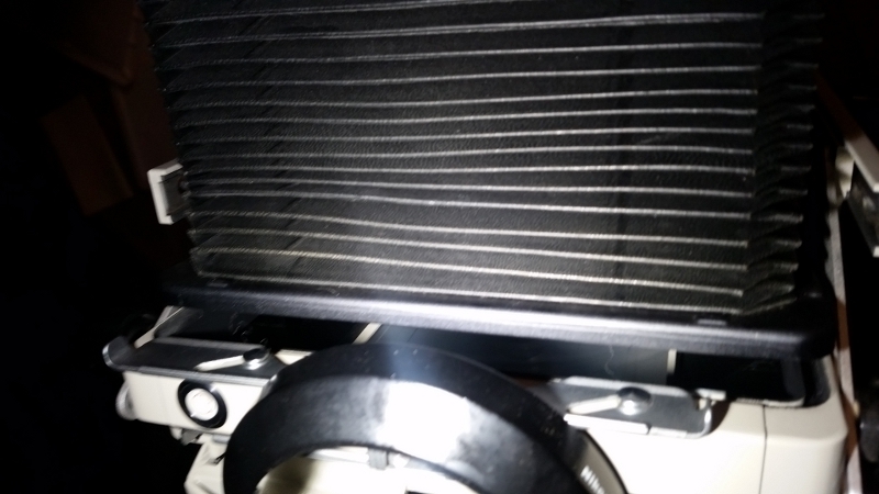

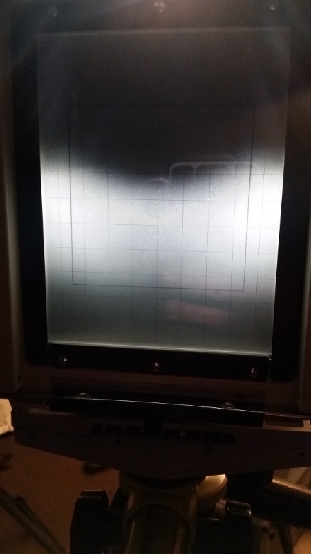

I was able to pretty quickly replicate it with my own 4x5.
I loosened the bellows where it attaches to the rear standard. I recreated the curved portion by placing a metal lens hood on the standard.
This was done by shining a flashlight on the TOP of the standard. Your images show the effect inverted.
So I suspect your bellows is not properly attached to the BOTTOM of the rear standard.
