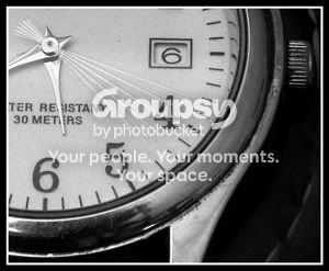

Depends on you. My 50mm is a great lens. Awesome for low light situations. But lately I enjoy the macro capability more. With the 50 (my macro is 60mm) I get more light, but I can't take shots like this. (And it's not THAT much more light)
