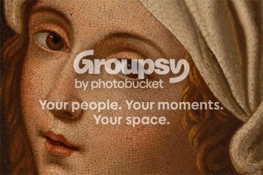

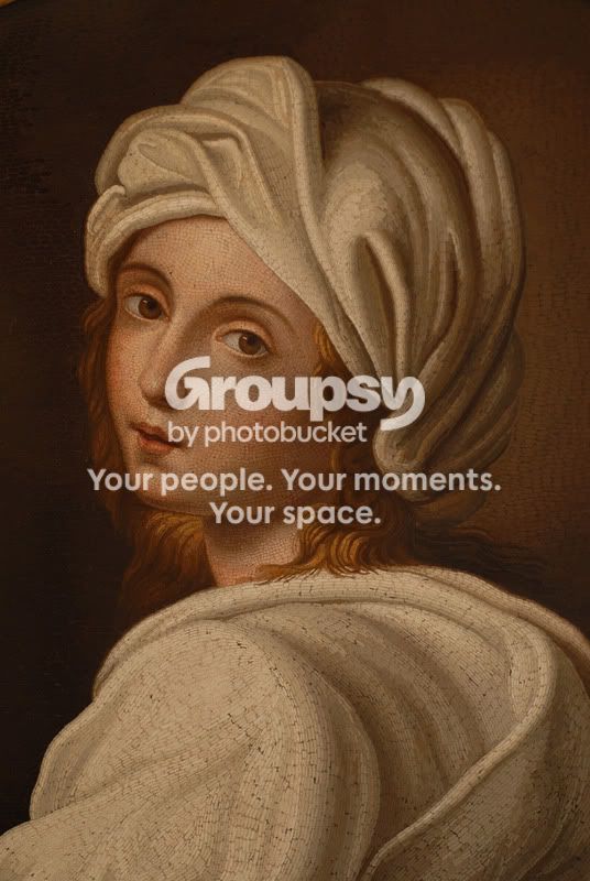

I shot some pieces for a local museum and used a 60mm macro as it has a 1:1 ratio. I would put it on the wall and not hit it with flash unless it is well diffused or you will get a hot spot on it. Find the right time of day in a nicely lit area and use a tripod. Shoot the frame and crop to size if framed.
The shot below is a mosaic that I shot for them so they could sell the images in the gift shop.
Shoot well, Joe
Joe, very nice! Did you use the D700?
