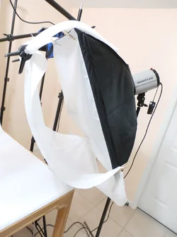

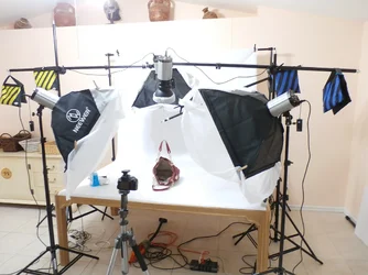

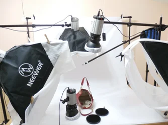

you are going to need a long list of things. As far as the photography is concerned :
1. White backdrop
2 one strobe for back light
3. Two side strobes.
4. Top light
5. I use a handheld strobe to illuminate interior of bag when needed.
6. Boom arms, one with fishing line.
My soft boxes are 4 times diffused. This really helps for reflections. Especially with patent leathers and reptile prints.
Two of my strobes are fitted with honeycomb grids, It gives a nice tight beam, when wanting to accentuate areas.
Photoshop. I do very little post production work. An unsharp mask, and possibly add some contrast. White levels are nearly always perfect.
Hope this helps. By the way, the larger effort is not the photography, It's cleaning the little buggers before the shoot. Cleaning these is possibly even more complex than the photography.
Most shots (99%) are taken at F11 s 125 @ 35mm
