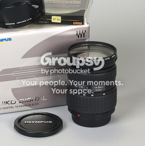

Here is a shot I did with above set up using tracing paper and desk lamps with standard 100 watt incandesant light bulbs.
The Ripstop would do better in my opinion as far a efficiency goes. But I already had all the above stuff lying around so it was all but free,
The quality " softness " of the light would be similar I would think

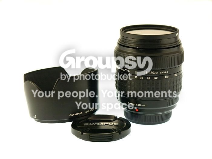

And this was shot on a light table, two 65w CF bulbs with shoot through umbrellas in Cameron light stands. The paper is banner paper and there was a 26w CF bulb from underneath.

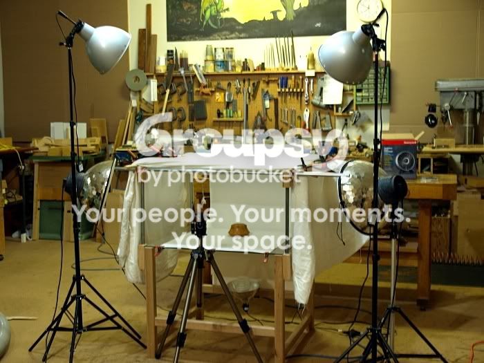

And this is the cobbled together light tent sitting on the light table....
to shoot this maple burl turned box by Jamie Russell....
I've since bought a light tent, built two soft boxes and ordered larger bulbs :)
