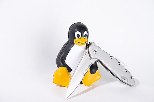

This is my creation, it cost like $3 in parts from lowes and it's still a bit elaborate. You could just go with a roll of paper and an armless chair or make yourself a light table.
I had to re-bend the support bar so it extended out farther. The nice thing about this is that it attaches to a light stand so you can adjust the height. The ambient was exactly what I was shooting in.
My results.
I was shooting with a Vivitar 285HV($90 new), a Canon 580EX II($400), and three pocket wizard PII's ($188 each). That's a bit over kill if you're just doing a basic setup, but it's part of my kit already and you could go with some used sunpak 383s($50ish?) and something cheap like sync cables or optical slaves if you're just going to be using it in a controllable environment.
There were shot at probably about 4:00PM with sunlight streaming into the living room. One flash was using a shoot through umbrella for a nice big light and the other was shooting up and bouncing off the ceiling to help control the shadows.
It all depends on how you want to do things I guess.

Normally I shoot about ISO 100, f/9 and SS 250 with this setup. I'd have to be outside in daylight to really get any ambient creeping into the exposure.
Plus it's much easier working in a well lit room where the only light you're getting into your exposure is from your flashes and not from any other unintended light sources. Plus it makes focusing and composing that much easier if your lenses aren't hunting for focus because there's not enough light.
