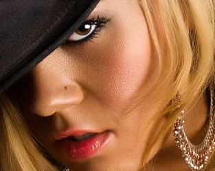

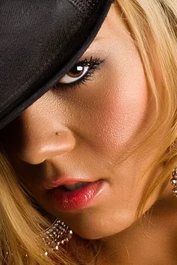

Here are a few crop shots I'll share. I am forcing myself to use LR only for faster workflow. I know how to do the basics in LR but always end up putting final touches on with CS6. So I'm forcing myself to finally learn to edit and repair in LR.
anyway, here are the crops to share. I can't share the whole image since there is boobs...but you can get the idea from the headshots anyway. I am finding I do less skin smoothing overall using LR as well, which is a good thing as I tend to go overboard often.
Too much on the whites of the eyes? at first I thought was fine....but looking back later I'm not sure. I like the iris, but the whites maybe too white...I dunno.
I like the vertical one, naturally the customer wants the horizontal one. lol. They always pick opposite of me it seems.
Whites of the eyes look fine to me, on the ipad anyway.

i thinking a little bit of smoothing would benifit from this photo just to blend in the pores and makeup.
I usually agree....believe it or not...I did run portraiture on her even in LR on that shot. lol . rough face, in a nice way.
Had I done normal way in PS, then I'd get the "she looks plasticky" comments. lol
Good thing I don't PP to please TPF vs client. lol
I do prefer the plasticky look on some women...and tend to do it. Really depends on their skin tones/complexion.
I might run it through cs6 tomorrow using my normal process and see the difference side by side, then maybe meet in the middle somewhere.

Me too. I don't think the whites are too much in the eyes. I looked at them before reading them and didn't even notice.
Cool...probly just my tired eyes. Looking today they seem fine.
Catch lights look wonky, too square.

It was a square 2 foot softbox. lol
Yeah...it is hard to not just say F it and close it and use PS, but I'm tryin. lol
quick update, above images look terrible in print. Gross.
Gotta re think the process. Def too much pores showing, even on 8x10 at viewing distance, you can count them.
So it needs more smoothing.
Eyes look decent enough at a viewing distance, but yucky up close.
