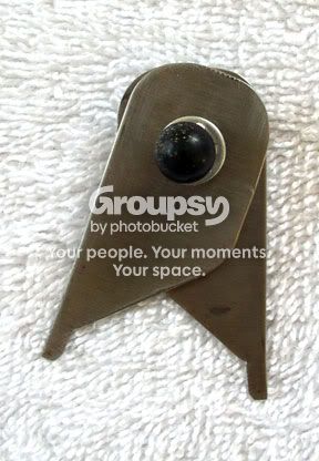

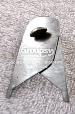

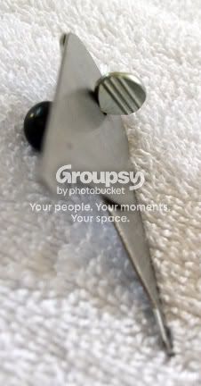

OK, you can make some at home like:
1 - a thin and long nosed plier tool with the tips filed down until they match the opening (dip the tips often in used engine oil so they stay tempered)
2 - make a tool from two identical pieces of steel held together by a 'butterfly' style screw (see photos below):

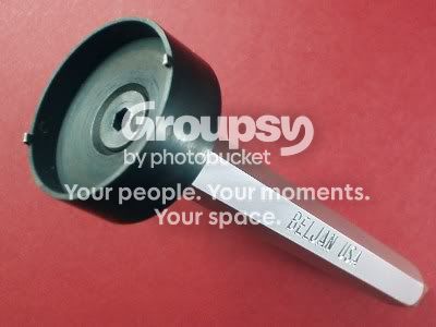

4 - machine something like this:
My opinion, buy the real thing if you plan to open lenses. The one you pictured I believe comes from Micro-Tools and it's one of the best.
