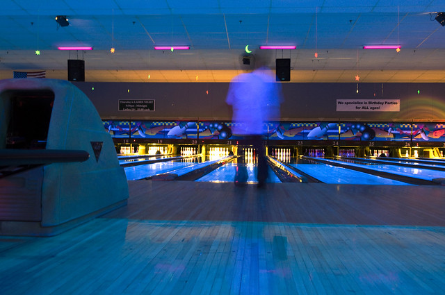

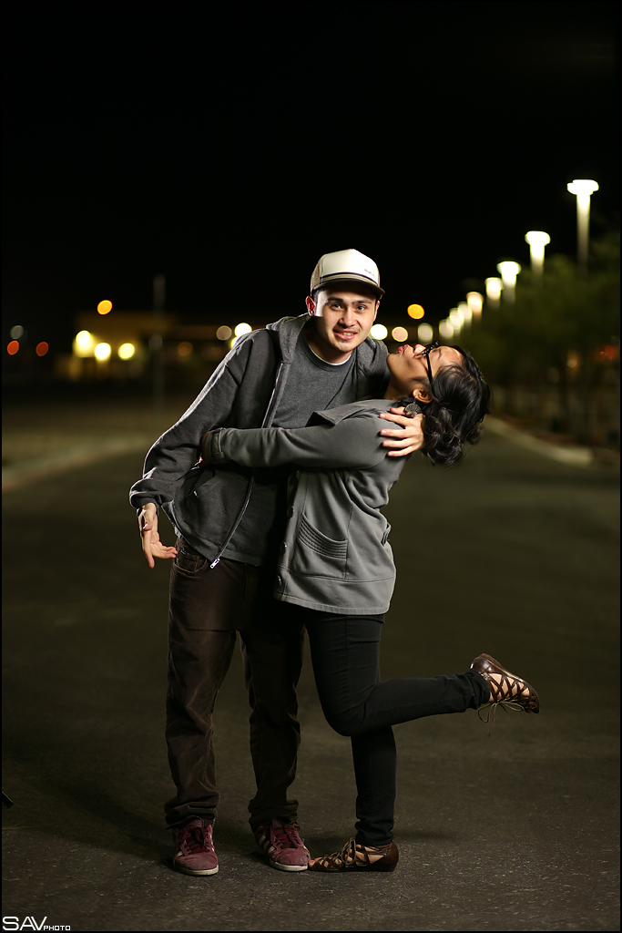

Not my shots but I'm looking for something like this:

Looking at your examples, only the first three are low light and the first two are using a flash, and the last a tripod.
If you want to shoot without a flash in dark environments you'll need a fast lens (1.8 or faster), and a camera with very good high-iso performance--preferably a full-frame camera.
