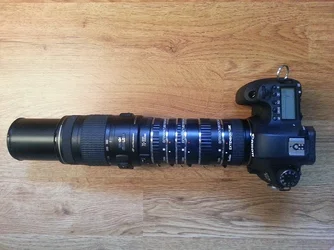

Adding extension tubes to a longer lens will address your issue, as you seem to have discovered. E.g. a 300mm.
My 70-300 at 300mm with like 150mm of extension tubes on it gets almost 1:1, and about 1.5-2 feet of working distance.
The loss of light is not that bad, either.
Problems that you encounter doing this, however, are that the 12 or so lens mounts for all the little tubes can end up being kinda unstable, and may break the electronic communication from flexing, etc. Plus you have to own more than one set of extension tubes. Macro bellows are probably a cheaper option.
Also, it looks kinda ridiculous:

I'm not aware of anybody who sells 300mm dedicated macro lenses, so unless I'm missing something, a setup like the one screenshotted above provides capabilities in terms of working distance that there is currently no other way to achieve. It will almost triple your working distance over the Canon 180mm macro, for instance.

Nikon makes a 200mm macro which is the longest native 1:1 macro lens that I've seen on the market. However a Sigma 150mm macro plus a 2*Teleconverter gives you a 300mm 1:1 capable macro lens (that can also go all the way to 2:1). A 180mm gives you a whopping 360mm.
That said the longer your working distance the further away you have to be and that also drastically increases the effect of handshake and also often makes it harder to lean on something local to get extra support. It makes tripods very important or at the very least monopods to help with the stability of the shot (yes you can do it hand held, but its a lot harder).
As for the using of two sets of extension tubes on a 300mm 0.5:1 macro lens I'm not sure. I can't say how the working distances compare, but it is a very front heavy setup. You'd also certainly notice an image quality hit (yes yes extension tubes have no glass in them, but the increased distance of lens to camera reduces the optimum sharpness all the same). It's something you'd have to compare, but which might just practically not be suitable to make it worth trying (I've not known many to ever use two sets of extension tubes).
Now you could use a macro lens attachment on the end of the 300mm; much more manageable.
The two sets can introduce more aberrations, yes. However, not nearly as many as you would expect by extrapolating from the effects on shorter lenses. A 300mm focal length is a very gradual spreading of light.
For the same reason that diffraction is based on F-stop, not on aperture diameter, it's no more of a problem than using extension tubes at more normal focal lengths. At 300mm, the errors propagate more slowly, because the light is converging more slowly and has less lateral movement per mm of backfocus. So the effect of CA and Spherical aberration are equal to what you would expect by adding about 30mm of extension to a 50mm lens. I.e. not much.
Would a dedicated 300mm macro lens have higher optical quality? yes, absolutely. However, they don't exist. So that's not an option. And the results of the two sets of tubes is quite satisfactory for anybody but the most demanding macro specialist (anybody who would find tubes acceptable in ANY circumstances)
I don't have a third set of tubes to get me to 1:1 macro quite exactly, but from using online calculators, it says that the working distance at 1:1 with just a couple more extenders would be slightly less than 1 meter, i.e. over 3x larger than the working distance of the Canon 180mm macro.
Also, for the same reasons, the light falloff is quite reasonable, also on par with the loss of light from using a 30mm extension tube or so with a 50mm lens. The setup I photographed above operates with somewhere between a 1-2 stop penalty, or roughly a nice respectable f/10.
