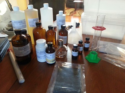

After accumulating all the chemicals and mixing them myself, I was able to make my first plate.

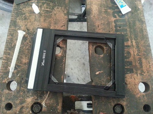

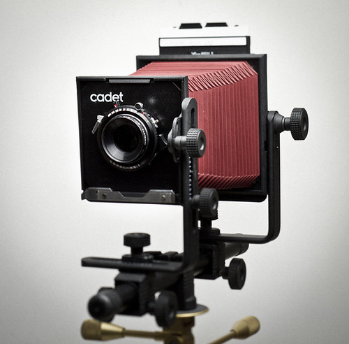

I have a cadet 4x5 view camera and I modified a sheet film holder to accept a quarter plate.

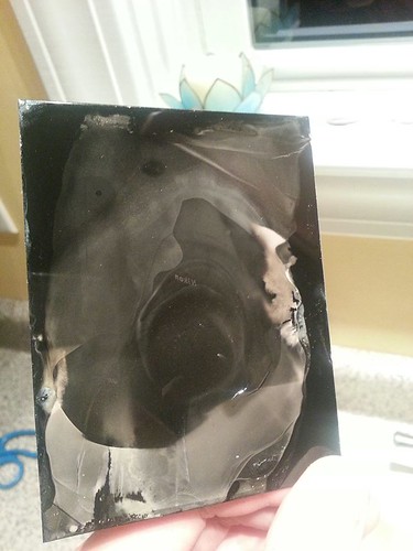

My first plates are pretty bad... :lol: but I'm trying to get the process down.
The developer for these wetplates are very short.. around 15-20 seconds, and I'm having a little bit of difficulty getting the exposures correct and also keeping the plates properly light sensitive out of the silver nitrate bath.
Here are a couple pictures of what I've done so far.
The camera:
All the chemicals I needed:
Modified film holder:
And my crappy first plate, haha:

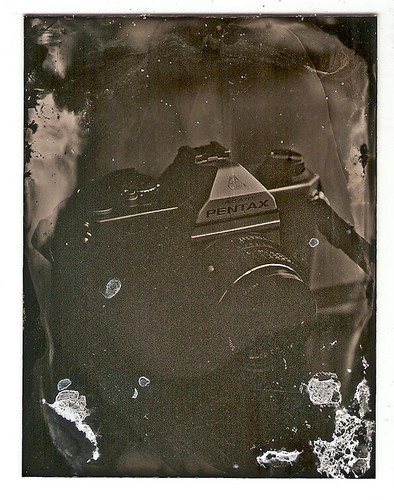

And, here's the best one I could do today.
Light-years better, but still awful:
The blotchy white areas are most likely hot spots from handling the plate after the silver bath, and the exposure + over developing accounts for a lot of the collodion artifacts. My goal is to have an artifact free plate with total control over the process.

I registered at Wet Plate Collodion Forum and just read everything I could.
My chemicals came from http://www.bostick-sullivan.com

That second plate, the one of the Pentax, is pretty subtle for a first timer. Who else would think of shooting the Pentax via a mirror so the name wouldn't come out backwards!
