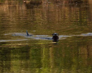

I like to hike and take pictures of the animals I find but they never come out as sharp as I want them to. I know a tripod would help but I usually don't have time to set one up. Any tips?

what were your settings for this shot?
Based on the tail (maybe shadow of the tail) and the file name, I'd say it's an otter, not a beaver.

It is an Otter. Actually there were two of them but didn't get a good picture of the two together. I was using Nikon VR 55-200mm f/4-5.6 lens and a D3100 body. My settings were 200mm, ISO1800, 1/640, f/11, white balance was on shade. I had it set this way because I was taking pictures at the same pond in the shade. I didn't get them to be very clear either.

Your settings look pretty good, although you probably don't need to use an aperture as small as F11. F8 would probably give you enough DOF and allow for a faster shutter speed.
As for White Balance, I'd suggest shooting in RAW, which gives you the ability to change the WB on the computer afterward.
I think we will need to see more photos and get more information, to diagnose your sharpness issue. The usual suspect is that your shutter speed it too slow. 1/200 with VR should be good, but who knows. (did you have the VR turned on? )
Did you crop the image at all?

I did shoot in RAW, since I do most of the time, is it best to leave the white balance on auto?
My VR was on. If I am shooting on a tripod, should I turn the VR off?
The image is cropped.
Different people have a different though process for this one. Some like to set the WB for the light their in (sunny, cloudy etc.) so they don't have to change it later. Others might take it step further and set a custom WB for the conditions they are in. Personally, I just leave it in AWB most of the time and do my white balance corrections (if needed) in Lightroom.
Yes. VR (or I.S. on a Canon) works via a gyroscopic effect, thus is has moving parts etc. But when the lens is perfectly still, that gyroscope will start to impart motion to the lens. So if you've been taking a bunch of shots (on a tripod) and they all seem much more blurry than they should...that is probably the culprit.
Of course, check the manual that came with the lens.
If you have any sharpness issues, cropping is just going to exacerbate the problem.

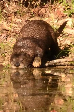

I figured out the JPEG compression and got it to upload. I had an opportunity to take some great shots like this one and managed to butcher them all. :) This has the same settings as the first picture except the ISO is 3200. I think my camera may not be able to shoot that high without having noise in the picture. Anything else you can tell me to correct would be great.
FYI, you should also resize your photos before uploading. That image is 3820x3055 pixels. A typical screen resolution is something like 1280x1024...so really, for displaying on a computer monitor, the files only need to be 800-1000 pixels wide.
Yes, ISO 3200 is getting pretty high for most camera, but a little noise is better than a slow shutter speed (and thus a possibly blurry photo).
The problem with this one, is that it's quite a bit under exposed. Looking at the histogram, all of the pixels are on the left side of the graph, so you could have gone much brighter without blowing out anything important.
