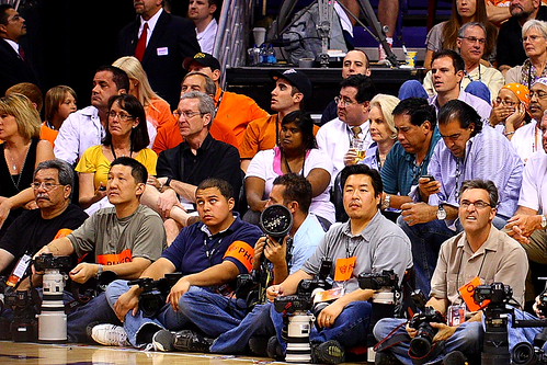

Heres what some were shooting during the Suns - Spurs series I went to.......... ( Thats Cindy McCain and daughter in the middle of the frame btw hah. ) Im not too familiar with any of the lenses off the top of my head.

A close look at the image j-digg posted and you can see all those shooters are using 2 bodies/lenses

It looks to me like the two fellows in the front row with the white lenses are using 200mm f/2 EF lenses, and it looks like the guy with the Nikon body also has the 200mm f/2 VR-Nikkor. The Canon shooter on the left has his lens shade on, the guy ion the right hand side is shooting without the lens hood. Canon EF 200mm f/2L IS USM Telephoto Lens - 2297B002 - Buy.com
Are they putting their lenses directly on the wood floor? Or do they put something on the floor first to protect the glass from the floor and whatever tiny loose particles (especially coarse ones like sand) might be on the floor?
They're on the floor on the rim of the lens a bit of dust or sand aint gonna damage the glass unless you start buffing away with a lens cloth. H
Yeah, and I guess they know not to do that, but still, I wouldn't do that with my glass. If I have to put one of my lenses down face-first, I put the lens cap on it first.
There's nothing wrong with doing that. For one thing, the lens on the far left has it's lens hood on, so the front element is about 6 inches away from the ground. But the other two guy look like it's just the rim of the lens on the ground. That can be done perfectly safely, as long as you're paying attention. I do it all the time. Front elemtns are surprisingly tough. These photographers don't have time to be messing around with lens caps, and they need to be switching back and forth very quickly from one camera to the other. Part of being a professional is acknowledging that protecting your equipment is secondary to getting the shot and doing you job. Being anal about caring for you gear is a luxury that professionals all too often don't have time for.
