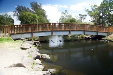

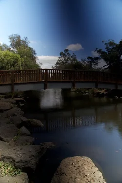

I am totally Frustrated ...i have been seeing photos of amazing water effects online.....and everywhere it says...u need ND filters for this..so i bought a circular ND variable one...i tried to use it today....and...the results were TERRIBLE...i turned the ND filter to near the darkest it can go.....and when shooting landscape it was dark on the top left and bottom right of the pic.........and worse...when i put the cam into portrait ......i had big thick black vignettes going horizontally through the pics....totally destroying it...i tried using both full auto and manual ...neither seems to give the desired effect...................really disappointed.if someone can please give me some advise it would be great

Sounds like you bought a circular polarizer (CPL) instead of a neutral density (ND) filter. I've never heard of a circular ND filter before.
I'm on my mobile right now, so I cannot see the images.
But I'll bet you dollars to donuts you bought a super-cheap VND.
Huh, I hadn't heard of variable neutral density filters before... do they work by using two polarizing filters at a variable angle to each other?
hi...sorry i should give more info....its an INCA pro 77mm variable ND filter..2-8 stops by rotating the outer ring...

By amazing water effects- you mean wanting a slow shutter-speed to catch the motion of the water?
Buy a couple of ND filters, 4x and 8x. you can stack them. Variable ND filters that use Polarizing filters have some interaction with polarized light in the scene. That seems like it was going on in your image.

Try backing the filter off from the maximum density. A lot of variable NDs do that when turned to the very maximum.
(It isn't interaction with polarized light in the scene, it is interactions between the two polarizing filters when exactly crossed. The VND may be a pair of CPLs, with the pola elements next to each other and the wave plates on the outside of the sandwich. This dramatically reduces the polarizing effect in terms of the subject - polarized light from the subject is first circularly polarized.)

As far as the effect, you are shooting at only 1 second shutter speed. The effect I think you want is shot at a much longer exposure. To acheive that, use something like a 10-stop ND filter. Also, I think getting down lower to the water level a little will help and yes, you are right - a little water movement is needed to create the milky effect you seem to be wanting.
I am assuming that what you are trying to get is for the water to look 'misty' and blurred while other elements in the shot look sharp. If that is so then you need to find some water that is flowing rapidly over rocks or a rough sea. Your photos are of a placid stretch of water with little apparent movement so you will always struggle to get the dreamy effect that you are after.
Also, if you cannot get a long enough exposure time with low ISO and small (high f number) aperture then get a decent neutral density filter not a cheap variable one. For the exposure times needed for the effect you want you will also need a tripod or somewhere solid to rest the camera.
