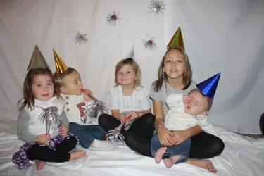

Hey everyone. I have a canon rebel XS, for which I just got an external flash, as I though it would be the 'answer' to all my problems. Still unsure about that thinking. I mainly want to shoot pictures of my family, specifically my children. I also like my cat! I am not too interested in outdoor or action shots, just portraits and family get-together's. Last year for Christmas, my sister in law and I got our five kiddos together and I tried to take photos that were themed for each month. What a hassle, and my pictures were crap! It was all in the lighting, and this is something I am stuck on.

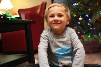

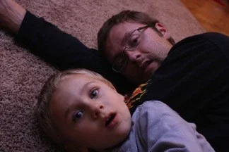

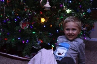

Fast forward a year, and we want to try this same thing again, but with less costume changes and a green screen. Basically, I am so completely overwhelmed with the amount of settings I can manipulate, and the auto function on my rebel SUCKS! So I mainly work in manual and just flip around through settings, hoping to get a good shot. I would love to put up some pictures to get our expert advice. The first picture is from last year, when I didn't have the external flash. The second two pictures are from today, with my external flash, and are pictures that I think are MUCH better. Thanks in advance for the advice, and hopefully the answers to some of these questions: Which pictures are better than the first (from last year)? Are there any that can be considered 'good'. Any good tips for adjusting those manual settings to get good pics, even if it is just a starting point

The bottom three are all, I think, better than the first one. I think the last one is the closest to "good" from a technical standpoint, it's got a good composition and good exposure and the look on your son's face is priceless. "Good" otherwise is quite subjective. I quite like the 3rd photo myself :mrgreen:. As for the settings, have you research the exposure triangle? That's the best place to start I think when trying to learn manual. Here's a link to an explanation of the exposure triangle.

I am no expert either. A lot of the learning that needs to be done can be read about from now to next summer but it won't do you any good unless you understand the advice (so read up on the basic terms/jargon and then you'll understand when they give you advice about said functions) I really just suggest doing shoots in different settings to understand the basic elements. To ME personally the color balance is a little blue in some, and exposure is a little low in the middle two I believe, and there is something about the way the photos have been framed that could probably use some work but I can't really pinpoint it.

The last photo seems to be the best out of the three, it is framed a bit strangely to my eyes and seems a bit unfocused but is more visually pleasing than the other two, and much better than the first.
