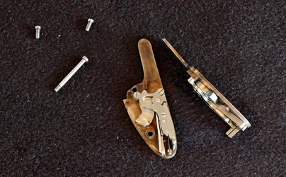

Here is an example of the type of photography I will be needing are at these websites: http://hollandandholland.com/gun-room/royal-double-rifle/ New Guns - Westley Richards Some of my photos that my photographer did from a previous article are below. I won't be taking very many pictures of a whole gun, mostly I need clear closeups of engraving and lock internals.
The best lighting setups I got with my past photographer was outside on a darker cloudy day. Light needs to be fairly even on all sides, or else there is glare on the metal. We also photographed once in a room with windows on three sides when it was a little overcast outside. We had reflectors and white sheets placed in the darker places of the room. With a black background it made some good results.
The best lighting setups I got with my past photographer was outside on a darker cloudy day. Light needs to be fairly even on all sides, or else there is glare on the metal. We also photographed once in a room with windows on three sides when it was a little overcast outside. We had reflectors and white sheets placed in the darker places of the room. With a black background it made some good results. H]
The best lighting setups I got with my past photographer was outside on a darker cloudy day. Light needs to be fairly even on all sides, or else there is glare on the metal. We also photographed once in a room with windows on three sides when it was a little overcast outside. We had reflectors and white sheets placed in the darker places of the room. With a black background it made some good results. View attachment 114645 View attachment 114647 View attachment 114648 View attachment 114645
If you want images similar to those in the links you'll need to work on product lighting more than anything.
