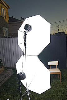

You have to love "affordable" kits. I am up to 6 lightstands and several 120V and battery powered strobes. Just tons of fun!
Even just playing around without any specific goals and you can have a lot of fun! I took these just on a whim while cleaning my equipment a little while ago.
