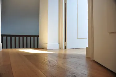

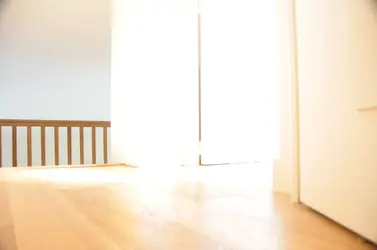

So I followed your instructions to the letter: first five, f11, manual shutter speed set to metered recommended level:

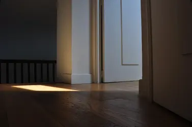

Then I did "f/3.5 at the shortest focal length, and repeat, with whatever speed is needed for f/3.5 and shoot the IDENTICAL scene as in step 2."

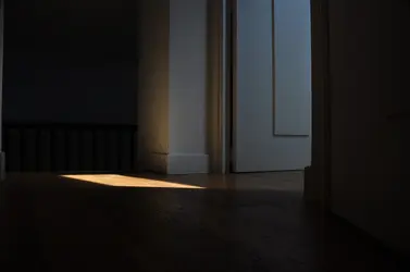

This looked - superficially - quite promising (although there are differences), so I carried on, and then this happened:
(Five shots further on, but with no changes to the camera or settings at all by me)
Personally I'm not sure how to interpret all this and whether the problem is "the iris diaphragm, OR even worse, the camera body's mechanical diaphragm actuation mechanism, is failing"
(PS, this was done with a brand new battery)
