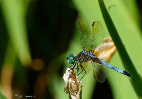

Macro photography. It's amazing on a longer lens (like my 300) how shallow the DoF is when you're close to the MFD.
This was taken at f/22 and the DoF is still too shallow.
