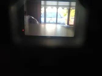

I did some reading up on the Metering system for the OM10, and I'm not 100% sure how it works. In the event that there are two systems and one happens to be in the viewfinder, there is a noticeable burn mark inside the viewfinder. Ill attach an image here. This is not visible on the mirror or the plastic panel(?) above it.
It's hard to tell, but it looks like the trigger switch, just below the electromagnet, isn't opening properly. This switch tells the circuit when to begin timing, and if it doesn't open and close properly, it will (at best) affect the camera's high speeds, or at worst, keep the shutter open like this. Why it may not be operating properly (if that is, in fact, the problem) is hard to describe -- there are so many possibilities, describing how it should work and why it may not, would take pages of text!
As far as the dark mark in the finder, it looks to me like the prism is developing a flaw. If that is the fault, it shouldn't affect the images, but replacement will require lifting the main circuit flex aside and installing a prism harvested from a donor body (1,2,10 all use the same prism).
