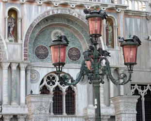

This is a shot that I made in Venice on a cloudy day, Canon DSLR, handheld on auto settings. I love this shot, but the motion blur of the shutter speed ruins it for any enlargements. I am basically trying to assure myself that this can be cured without carrying a tripod. Sometimes it just isn't practical.

Are you sure it's shutter blur? I don't really see it in that photo but maybe it's the way it's sized or shows up on here. I'm wondering if it's more the exposure.
I can see in the upper right corner what looks like maybe a hazy/overcast sky in the background that still could have been bright enough that if the lens shut down too much that might have caused the shutter to be set slower (to let in more light to compensate for a small aperture) depending on the ISO.
I shoot manual settings and rarely have used modes etc. but maybe using aperture priority isn't always the best option if you don't want the shutter speed to go too slow. It should be possible shooting outdoors in daylight to get a fast enough shutter speed to prevent blur.
