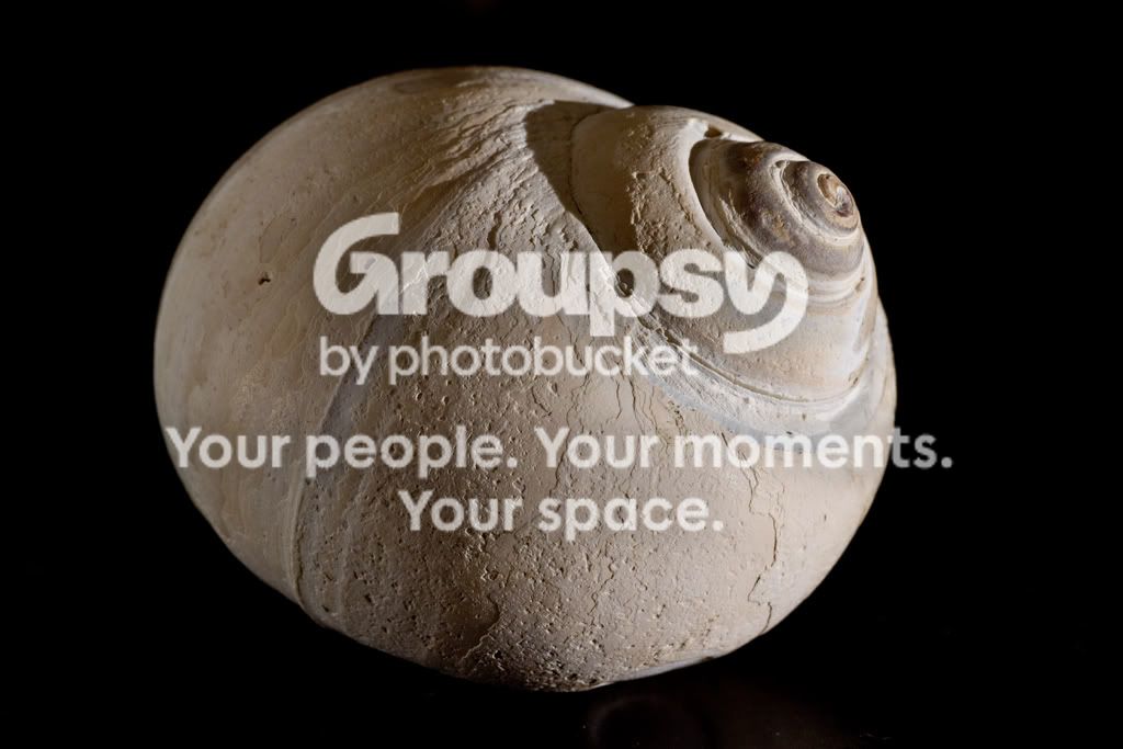

Here's an image that I took of a 1.5" seashell, where I was interested in showing the texture of the pitted surface. It was taken with a macro lens, with two flashes (main on right, fill on left) in manual mode (to control the ratio of light), with the focus achieved by life-view focusing.

LOVE that photo, and though I would not want that much of the fiber in shadow-it's exactly the texture result I would like to get (and didn't even know I wanted 3 days ago!!) What a great resource you all are!!!
