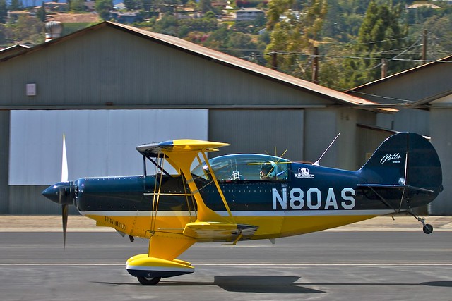

I got the chance to borrow a Canon EF 100-400L this weekend, what an amazing lens. I was working on panning... I was trying for two things. One: Try get the subject as sharp as I could regardless of background.
This is the best one I got...
ISO 200 | f/5 | 1/1000
Two: Try for a nice motion background blur while still getting a sharp subject.
I have found a professional example of what I'm trying to get. The image has their watermark so I'm not sure if I can post it on here or not for example purposes.
I just cant seem to get the subject sharp. I've tried shutter speeds as low as 80. I get the background motion blur but the subject is always fuzzy. Do I just need to get better at panning or would using a tripod help?

So it is possible to get that nice & sharp kind of panning shot hand held at the lower shutter speeds? These guys aren't using a tripod or some fancy gyro stabilizer?
Yeah having the lens in the right mode would help... I had the modes mixed up. I guess it's just practice. I'll got out next time and see what I can do with the IS off.
