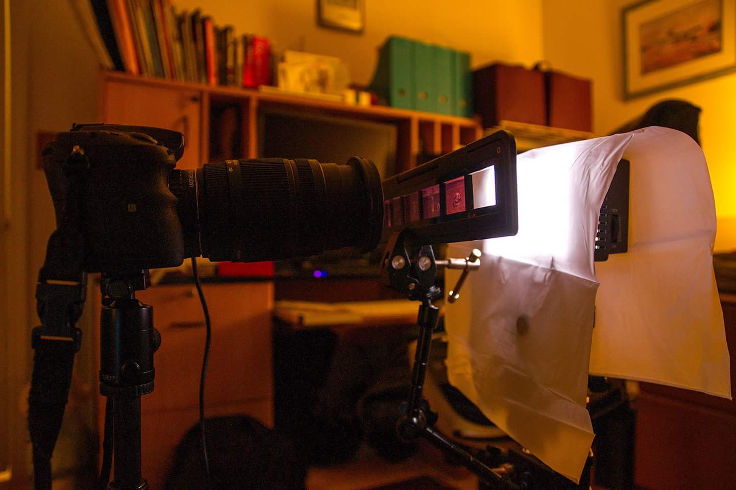

Extension tubes will also let you focus very close to the negative -- with the lens almost touching the negative. I use this:
https://www.amazon.com/Fotodiox-Ext...&keywords=extension+tube+sony#customerReviews
I think any lens will do. But matching the "mm" of the lens with the "mm" of the extension tube as close as possible will fill the entire frame (or viewfinder) of the camera with the negative. In my case, I use the 20mm extension tube on my 18-200mm lens zoomed in at around 20mm.
