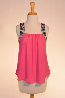

Ok, so I'm making some progress....I think.
I bought a D5100 and I'm really immersing myself in a bunch of photography literature. My photos have gotten better, but I think it's time to spring for some high quality lighting if I'm going to go from this:
to something more like this:
http://productshots0.modcloth.com/p...d994a17534f2dbf66936d6c91f3c81.jpg?1369172601
Correct me if I'm wrong, but I probably need a fill light opposite my main light and I need a light capable of blowing out the background. The Alien Bees Busy Bee package looks intriguing to me and I've found it used for about half price of retail. Would this be a package that you would recommend for this kind of studio photography? It seems to be highly thought of.
Thanks for the continued assistance.
You're definitely making progress! For what you're doing, a simple high-key setup can be acheived with three lights 200 w/s per light will be more than adequate. Alien Bees, Flashpoints, or Elinchrom 'D' Lites will work just fine for this. Two lights into softboxes for the background and one into a large softbox (>48x48") as the key for the clothing and you'll be in business. Set your key so you get an nice, bright, but NOT blown even subject and then set your background lights 1/3 stop over that and you should be in busines. If you want to get really tricky, you can gel the background lights with different colours to produce all sorts of interesting effects.
The Busy Bee package looks like a good place to begin. As you are talking to the Buff people, tell them what you're doing, and they will make suggestions, and perhaps make a few substitutions in the package.

Wow. That last shot really is an improvement. Also, I think I might have to snag that lighting set up for myself for the stuff I'm going to be working on soon. O_O Thanks for the link!
