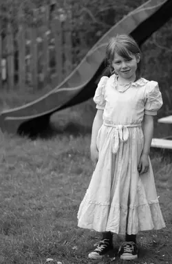

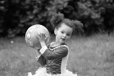

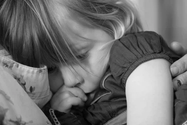

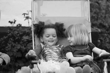

"Tips and tricks" don't get you by in business. Solid skills and lots of practice and a thorough understanding of technique do. A few suggestions: Watch your point of focus. In the first one, the point of focus appears to be on the ball, the side of which is tack-sharp and NOT the eyes (which is where it should be) which appear just slightly soft. Portrait work is best done, IMO, with a single focusing point placed over/between the eyes, and using sufficient DoF to ensure that the "front" of the face is sharp. Suggestion #2: Just because your lens opens to f2.8, doesn't mean you should use it at 2.8. In image #2, the DoF is so thin that the sleeve cuffs are sharp, but the sharpness falls off rapidly toward the face. Suggestion #3: Use appropriate shutter speeds! 1/30 second with a 100mm lens is probably not a good option. Suggestion #4: Work on composition and be cognizant of the background elements in your image. In the case of #4, the slide, which cuts right through her head provides a strong diagonal element which draws the eye away from the subject. Watch your exposure and avoid blown highlights in/on/around the subject such as the dress in #4.

2)Again, far too much top space. Vertical might have been better.
3) I get this one. Okay, not too bad
4)Girls and wavy slide: she's too far to the right, causing visual tension. Maybe move her back, to the slide, and place her right hand on the slide railing? One step over for her, and that annoying background 'thing' disappears. If she were moved back and to the slide, it would be an entirely different kind of picture; she would be "interacting with" the playground equipment. As shown, she is a girl, in a play area. Good job on not cropping off her feet.
