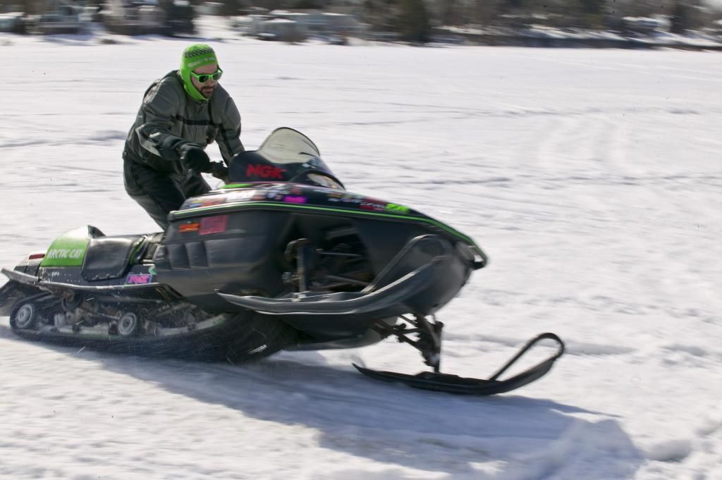

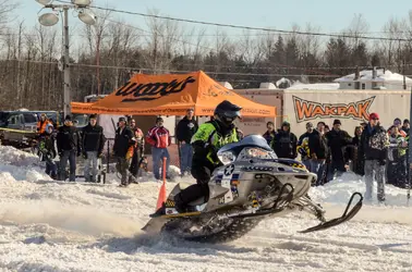

So I'm a commercial photographer by trade and can shoot very well in studio. However I have very little experience shooting in a photojournalistic style and am trying to improve as I have many hobbies that include toys with engines. Lately I have been trying to work on panning and was hoping I could get some pointers for this technique and any other sports techniques I might want to try.Ive included some images so you can see where I currently stand in this feild of photography "yes I know they are not expertly shot" but it should help in reference to where i need to improve.
The first two were shot in AV mode auto focus set at servo low ISO with a 70-200 lens. The other three in TV mode with a high shutter speed 1000 I think low ISO servo focus. any suggestions would be appreciated!

I like #1 in the second set. I've never shot snowmobiles, but I'd guess it's a lot like BMX / motocross-type shots. If you catch a lot of flying snow, you're going to have a good sense of speed regardless of any panning. Watch out for distracting bkgds -- the houses & docks in the first set are probably great if you're trying to sell lakefront property, but they take away from the snowmobile action, IMO. I think the airborne sled with all that flying snow might have been cool if you could've isolated the subject more and gotten in a little tighter. If you take that shot from down low and nail the sled with nothing but blue sky behind him, you'd never know it was taken on a frozen lake (ok, that might be a little optimistic, but you get the idea).
I totally agree, the biggest thing i learned from my first trip out was different elevations are key. Doing that on a flat lake is super difficult, that's why on the next trip out I decided to shoot on some hillsides it made one hell of a difference. I'm hoping I can build a jump on a hillside in the future and get the type of shots you're talking about.
