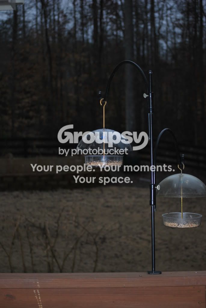

hey gsgary here is the photo i took using your setting. It worked. Hope this picture is not too big if so i will resize it.
F/4.0 @ 10/250 sec ISO 100 (is that what you mean by Exif data?)
