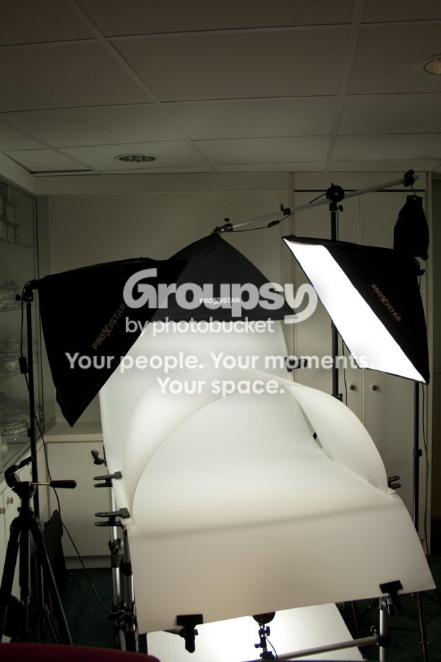

This is how I have lights and the table set-up

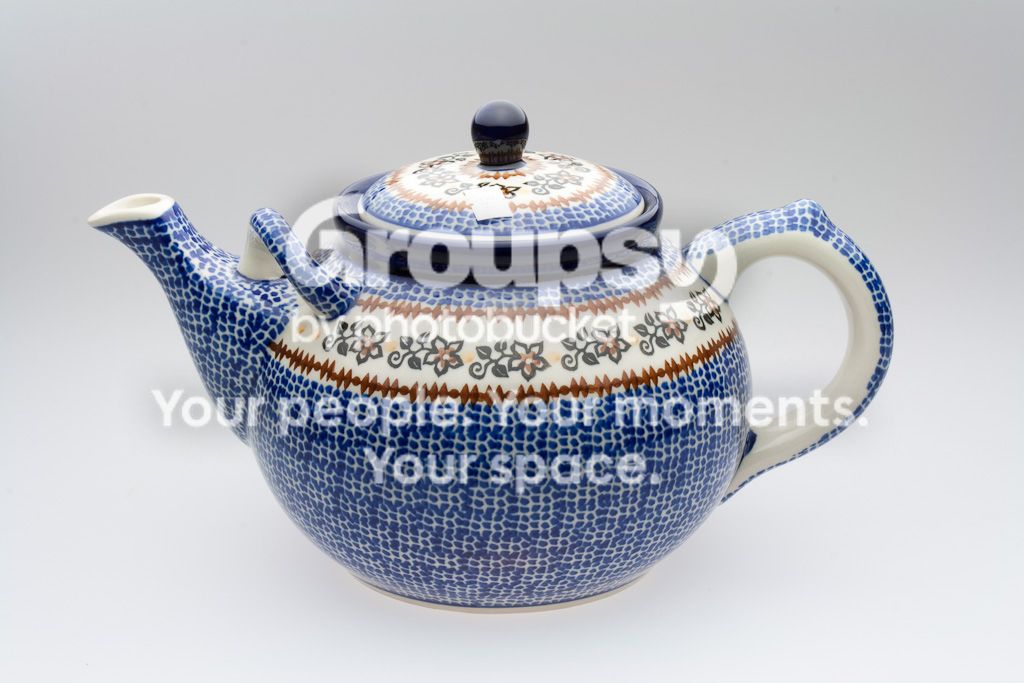

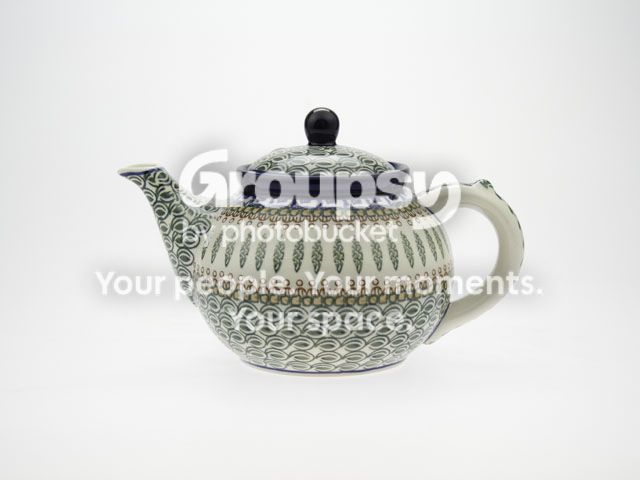

This is how the shots turn out after some color correction in lightroom

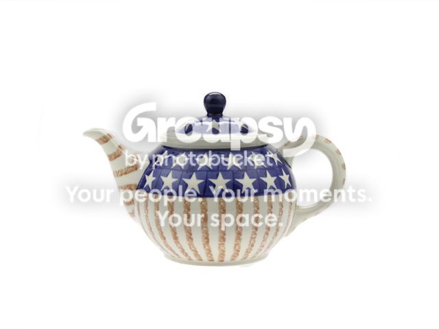

And this is the result of a few minutes in photosohp

You will never get blown white backgrounds with the product sitting on it.
You have to light each seperately and be careful of light spilling from the background onto your subject.

What Bitter said! Light background first... anywhere from a .5 stop to 1.5 stops over ambient... then light the subject separately. you will need probably 4' to 6' between background and suject to prevent light spill.

Have photoshop? Setup your gear.. take a shot of the background with the lights.... measure it using the color sampler tool. You want it at 255/255/255 across the board (the entire background that will show up in the shots). Write down your settings... once you have it set, it wont change.
Once you figure that out... then add a subject and get it lit properly.

Also I feel you are over-diffusing it with the dome diffuser and that likely results in less contrast, sharpness and shine on your final images. These pots are not that reflective I believe?
With the curvy shapes like these, I think you will have some light spill regardless if you keep trying to have it pure white on the background... I would also try to light it up from behind the background on the back (can't see if you have something there already) - this often helps with the white background control on light-colored objects like these.

Would that diffuser be the curve over the table? I do photograph shiny objects and that curve helps in killing off hotspots on the objects since I photograph in the store which means I do have some spots behind me but I could try removing that and see if that creates a little more pronounced lines between the teapot and the background.
I think my on of my biggest problems also is that the light lighting the background is not big enough, the middle is pretty white but it falls off rapidly towards the edges.

After about a 100 pages of Light, magic and science I thought I'd give what I've learned so far a try.
The following is what I came up with, I like the lighting of the teapot itself, but still not satisfied with the background.

I think you're almost there. I would suggest to.....
1) drop the vertical height of your side lights to level with the product or at least the bottom of the soft boxes. I would probably try having the lights slightly closer to camera position and feather the light towards the background first and adjust as necessary. I would apply the feathering technique to the top light as well and have the bottom and back lights dead on center.
2) add a background light (behind the backdrop) facing object. Similar vertical height as side lights.
3) possibly start the sweep further back in the frame.
4) move your lights right up to the difussion panels.

Yes I was referring to that curve diffuser which makes it all too diffused as the softboxes already have it diffused pretty well. This extra curve layer would help with shiny reflective metal, electronic screens, jewelry, but the teapots are not that reflective I believe and will not show much of your surroundings especially on small web images - but that is just my impression from the image. It feels a bit flat and too soft so some more pronounced light reflection would help I think.
I probably should've added that for the last images I removed the arc and used the boom right on top of the teapot angled slightly towards the camera.
The other two lights I used to light the background although I'm not too happy with that, we have transparant acrylic stands in the store for display, I'll see if I can play around with one of those.
I also have a light under the table which removes a lot of the shadow under the teapot although it does slightly wash out the contrast between the teapot and the table.
I'll play around with moving the light from under the table to light the back and play with the side lights while the teapot is on a display stand, I'll be sure to post the results here : )
