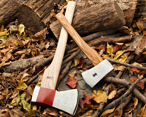

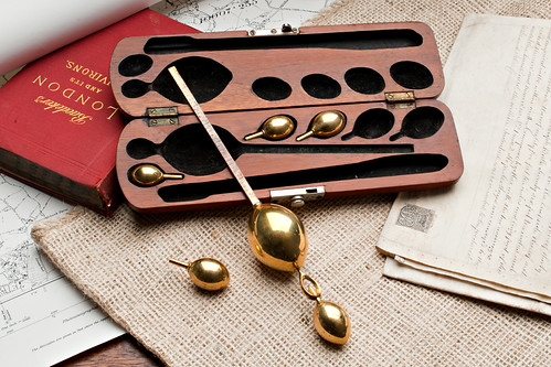

Our main light is a 4 ft x 4 ft softbox with four old Speedotron strobe heads and four separate modeling lights which are household incandescents at about 2700 K. I use the modeling lights most of the time. First two taken with incandescent, third with strobe.
