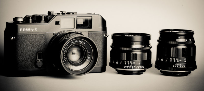

This is the original Cosina-made Voigtlander Bessa-R, the Leica thread mount rangefinder camera that was in large part, responsible for the new "rangefinder renaissance" which began in the late 1990's. At that time, the only true 35mm rangefinder "system cameras" were new or used Leica,Canon, Contax, or Nikon models, many of them simply priced out of the range of people who just wanted to try a 35mm rangefinder. The affordable Cosina-made Bessa-R soon lead to many different models, and Cosina's chief took the whole rangefinder project seriously, and Cosina began manufacturing MANY fine rangefinder (and later, 35mm SLR) lens designs, offering excellent optics at a fair price. Cosina in effect, became the world's largest third-party manufacturer of NEW and affordable lenses for Leica screw mount and Leica M-mount lenses, as well as the first "modern" manufacturer of brand-new lenses for discontinued rangefinders, like the old Zeiss Contax models, and the long-discontinued Nikon rangefinder cameras in the Nikon S-series.
Bessa R shown with 35mm f/1.7 Ultron aspherical, 50mm f/1.5 Nokton aspherical, and 75mm f/1.5 Color-Heliar lenses. An entire rangefinder and three-lens kit for less than half the price of a single 50mm Leica lens...that's what made the Bessa series of cameras and the Cosina lenses the start of a rangefinder renaissance..."value".
