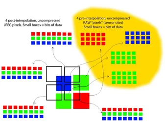

I'm sorry to hear that. Here are two other more visual methods for you, in case you are a visual learner:
Or if you prefer seeing the binary laid out, four uncompressed jpeg pixels would require something like this on a storage medium:
(11110010)(10111010)(10100101) (01011101)(01001010)(10110010) (10100101)(01010011)(10101010) (10101010)(01010101)(11010101)
While four uncompressed uninterpolated RAW sites would require something like:
(010110101110) (100111010101) (010010000011) (101010110011)
