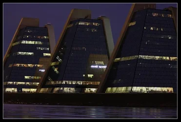

These aren't fireworks, but I did take these after I got off of work here in Indy. I used a remote shutter device and a tripod. The tiniest shake of the camera will cause the image to blur. I mean the slightest movement while taking in the dark.

Ok this thing resized my images so they are not as sharp as they are on my end. Anyway yes you could also use the timer if you don't have a remote shutter. I bought one for a little over $20.00. That's not expensive to me, but certainly not cheap. I know they have better ones out there, but mine works just great!
