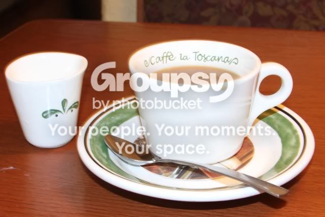

I have a picture I took last week-- I am not sure it's exactly like the problem you have posted- It's a refection off of a cup?? I don't know why it did it.. -- but I'd share if you like?
ok- I am sharing anyway. Maybe I used a flash- But even without a flash there is a slight reflection.
Thanks for the posted info on my lenses.
As for your photo Sunny, I'm not 100% sure what you're referring to.
I see a reflection inside the cup, but that's simply because it's liquid I would think.
I do see some fuzziness around the edges of the smaller mug, and around one side of the plate. It ALMOST looks to me like you moved the camera a touch, but I'm in NO way an expert on this, so I'm probably way off and it's something more technical than that. :)

See, I'm new, brand new just born. Just tossing that idea out there. I didn't see the reflection in the cup when I was looking at it though???
