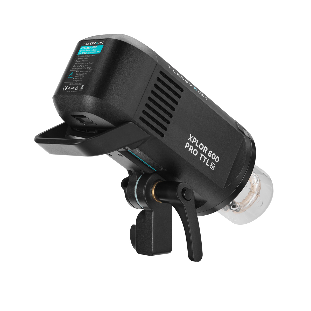

I have an AD 600 Pro strobe that has the Bowens mount and comes with a reflector that is 3" long and 5" across. So far I have been using it either with an umbrella or Bowens mount soft box.
I would like to start playing with gels and directional light.
I can not find a Bowens mount barn door. It appears that they are either held on with 4 set screws or lock over the reflector flange with a spring latch. All of the clip on barn doors seem to fit 6.5" to 9" reflectors with a flange. As the AD 600 Pro does not have this, do I also need a 7" reflector or is there another option?
Are barn doors and gels typically used together? I see lots of kits that come with barn doors and 4 color plates that "snap" into the barn door. What I can't find is how to use other colors with these sets. Do you just cut out the original color then use it for a fame to hold whatever color you choose?
I see many images of gels just "clipped" onto the flange of a reflector. Again that is not an option with the Pro, could I just gaffer tape the gel on? How much space is needed for air flow? How much space can there be around a gel before the white light over powers the color?
A 5" diameter reflector is a non-standard size, and going to make using accessories such as clip-on style barn doors a challenge. A standard, 7" reflector would definitely make life easier, however...
I've got at least two gel holders in my bag, and I almost never bother with them. I just gaf tape them in front of the reflector and be done with it. If you're using proper flash gels such as Rosco or similar, they are very heat-resistant; I usually tape them top and bottom so that they bulge a bit and leave an air-gap at the center. Cut them a couple of inches wider (say 10x10") and you won't have to worry about spill.
Barn doors and gels can be used together, but they are not 'typically' used together; commonly, and especially in consumer-grade gear manufacturers combine a gel holder into a barn door set to save money. Don't worry about those cheap "4 in 1" sets of filters... more of a PIA than they're worth usually.

No need for barn doors, all you need is a reflector with a rolled lip, which is virtually all reflectors sans the Godox default reflector that comes with the AD600 and AD400. The Godox “Standard” 7” reflector in Bowen’s mount is an inexpensive replacement with a rolled edge to clip gels to with a C-47.

This 7" Bowens reflector will work with your AD600Pro and has a rolled lip to attach gels for $12.99, Godox Standard Reflector (7")
Also, as universal as the C-47 is, I actually prefer 1" binder clips when clipping gels to round reflectors. They don't slide around and can hold on to a gel even when a grid is inserted into the reflector with one caveat, due to their metal construction they can get hot.

because of how long/tall the bulb is off the mount really.
I think the gels would collide, and the barndoors wouldn't really have much control.

I watched a test video that showed that 5" reflector produced less light than the 600 non-pro.
What makes you believe it will not work with the 600 Pro, which is a bowens mount?
Makes sense. Too bad they do not post any specs or pictures from a side view.
Just to make sure I understand correctly, should the base of the bulb roughly align with the base of the reflector?
