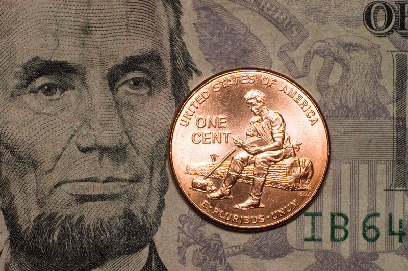

If you keep the subject matter perfectly parallel with the back of the camera, you have something like one millimeter's worth of depth of field to play around with. As overread points out, it can be very difficult to see through the camera with the lens stopped down to working aperture, so the small LED flashlight as a focus-assist light makes a huge amount of sense. In the above photo, I could barely see through the stopped-down lens, and ended up shooting ten frames just to get a couple good, sharp shots where the depth of field band was precisely aligned with the penny's surface and the currency's surface, which was about .9mm behind the coin's main surface, give or take.

Derrel: Great shot of Lincoln-moneys! Thanks for the info and the DOF tip!
