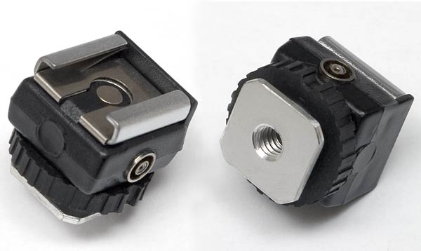

Yeah, there are a couple of KEY differences between the SB-800 and SB-600 that are important... like the fact that a SB-600 has no sync port (SB-800 does).
The solution to that is simple... slap one of these on your lightstand and wire it to your receiver:
It adds a little to the cost but it does something that is important for me... it lowers the flash and centers it closer to the middle of the umbrella and it gets the flash off that very wobbly and weak Cactus receiver bracket.
