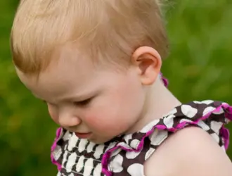

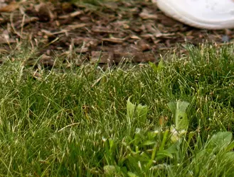

Yeah it's tough to judge the focus cause the viewfinder isn't that great either of course. I've been using the center focus point since it's the only cross-type point there is. (Hoping it's the most accurate.) So I'll put the center point on the face of the subject and lock focus and re-frame. (Without moving my feet or the focal plane of the camera the best I can.) And I'm not shooting at 1.4 either, like 2.2 or 2.8. I realize thats still pretty shallow but it's feeling consistently off. Here's an example of what I'm talking about. Locked focus on her face, re-framed and shot. The focus is sharpest in front of her feet in the grass. I feel like her hair and eyelashes should be as sharp looking as the grass is??

How about trying it without recomposing? With a shallow DOF like that the slightest movement can throw focus off so recomposing may not be the best method until you have some more practice with it. Most people who just get a fast prime usually end up having focusing issues because of the shallow DOF - and that's without adding in recomposing. I'd definitely do some focus tests (you can find them online) to see if it really is the camera lens or user error
A couple people have mentioned "practice". I guess I don't know how I would practice? Would I need to practice how I move my hands to re-compose? (Totally asking for real. Not being a snot.) Or does it come down to better bodies with more cross-type points, so re-composing isn't needed?

I don't know. I never recompose. But I would assume - practice as in knowing exactly how much and which way to move without throwing off focus.
Seriously everyone has focus issues when they get a prime and start shooting with large apertures. Did you have issues with this before??
At f/2.8 and standing 5 feet from your subject you have about 5 inches of depth of field. Some of that is in front of and behind the subject. The slightest movement (like pressing the shutter button) could possibly cause missed focus. Maybe try practicing with shallow depth of field without recomposing first. Yes most people need to practice shooting at wide apertures to nail focus.
The center focal point is more accurate but have you tried any of the others. It doesn't necessarily mean they aren't capable of accurate focus.
She probably moved a bit where the grass did not that's why she looks slightly out of focus... Kids are the hardest to capture... Try taking pictures of objects that don't move and see how your focus is
Save your money, and your anxiety. The forums are full of 'issues' from folks with new fast lenses. There are certainly advantages to a faster lens, but the shallow DOF does take some learning, and patience. There is nothing second-rate about the focus of your T2i. I have been shooting for over three decades and selected the T2i because of its lower weight, consistent with excellent performance. It doesn't matter whether I have on my 70-200L, 15-85 or 400L my focus is always tack-sharp. And that includes a great deal of Birds-In-Flight, where again the T2i is as competent as any DSLR.
This slight misfocus can occur if you use the wrong focusing mode.
When an object is moving you should use AI focus or AI Servo mode. If you stay in "one shot" mode, you will most likely miss your focus.
