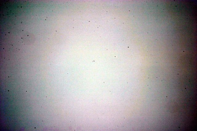

Used 10D I bought last year on eBay - Before
Cleaned: first time using the kit,
Note that much of the junk was wiped over to one side.

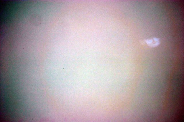

New pad, cleaned again.

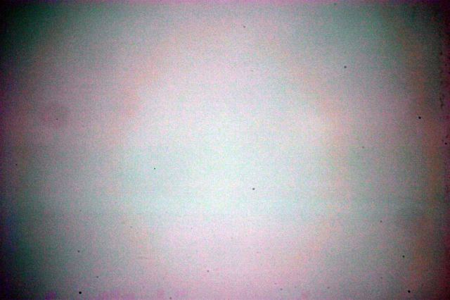

Getting better

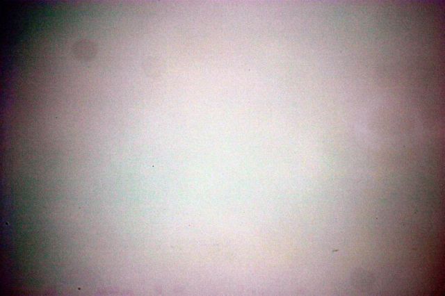

Third Cleaning, one new spot, one smeared spot.
Time to just leave it alone. :lol:
I'd say this was a success?

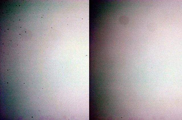

Below is Before and After, half the sensor, side by side.
Don't know what the blobs are? They don't appear to harm the photos I take. Test shots used Blank monitor screen.
This is scarry
and it tells me that I should leave my one spot alone.
