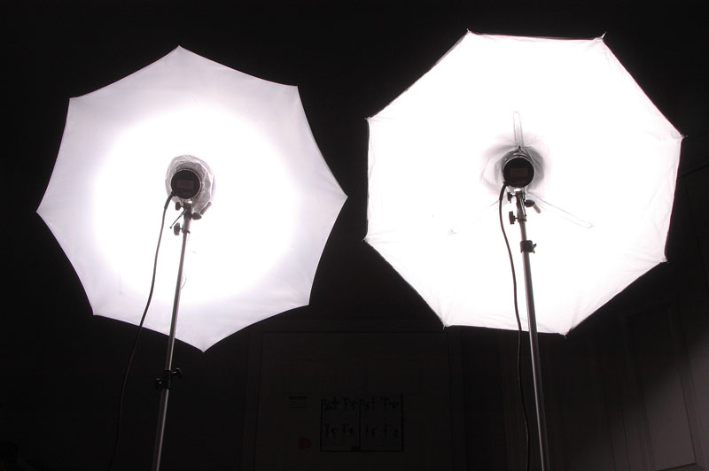

Left: $19 Cheap Chinese imitation Right $75 genuine Lastolite Umbrella Box.
Both fitted with identical speedotron MW3U (aka 'umbrella heads") flash heads firing at 200 watt-seconds.
They look "similar" in appearance, but the cheap Chinese knock-off has a severe hot-spot,
and edges with very rapid fall-off. Cheap Chinese made modifiers often use cheap fabrics
with UV enhancers, to make the fabric appear "white" to the human eye.
So...yeah...the imitation and the original give identical results? Right? I mean, who you gonna believe?

Well, somebody above said he is "sure the light quality is the same", and impugned the name and reputation of both Photoflex and Lastolite. MY EXPERIENCE is that the Chinese-made stuff has a different color temperature and different materials construction than the "name brand" stuff. Like the Lastolite Umbrella box, which I have personally been recommending since 2007; it has a "special" white diffusion material on the front of it...it is "thick-ish", and "semi-transparent"; the closest thing I could liken it to is frosted Plexiglas or "opal glass", which is/was used in slide duplicators and some enlagers, to create a very SMOOTH and EVEN diffusion of the light.
The cheap Chinese umbrella box, which I payed $19 for, used regular old shoot-through umbrella type material in the front, and it does NOT create an even diffusion of the light. As you can see, it has terrible edge fall-off, and a VERY "hot" center...also, the black fabric on the back--the Lastolite is a sort of rubberized-feeling, THICK cloth that allows ZERO light to come through, even when firing 800 to 1200 watt-seconds of flash through one light head....the Chinese umbrellas use "regular", black-dyed, woven fabric that is nowhere near opaque, and light comes out the back side...meaning that when two umbrellas are aimed toward the subjects, and the photographer is behind the umbrellas, on the black side, there is a LOT of spill light blasting toward the lens with the Chinese-made cheapies, and the Lastolites are light-proof,and are NOT flaring the lens... I myself recommend and use the Lastolite Umbrella Box 40 inch umbrellas with the 7mm diameter shafts. I stand behind the product's results. Its sewing sometimes needs a bit of assistance with the rib end-caps and an extra stitch or two, but the "quality" of the light is beautiful.

@Derrel: looking at your example, I’m wondering if the“focal length” of the umbrella has something to do with the pattern you are showing. The Lastolite umbrella shows an even pattern that one would expect if the flash was at the focal point of the umbrella’s curvature. The “Other” one either has a stronger curve than the Lastolite umbrella, or the flash head is further away from the umbrella’s focal point (actually, closer to the umbrella on the axis), or both. If my guess is correct, then the positioning of the flash or light at the correct location/position relative to the umbrella axis and curvature becomes very important.

@Derrel: looking at your example, I’m wondering if the“focal length” of the umbrella has something to do with the pattern you areshowing. The Lastolite umbrella shows aneven pattern that one would expect if the flash was at the focal point of the umbrella’scurvature. The “Other” one either has a stronger curvethan the Lastolite umbrella, or the flash head is further away from theumbrella’s focal point (actually, closer to the umbrella on the axis), orboth. If my guess is correct, then the positioningof the flash or light at the correct location/position relative to the umbrellaaxis and curvature becomes very important.

As far as the "focal legnth" of the umbrella, or the curvature: the cheapie is set up with the flash head set along the umbrella shaft at the same distance as the Lastolite. On both, the front panel fabrics are "tight", and the flash head could not be pulled farther away, because the fabric was drum-tight...also, the curve of the two umbrellas is different...the Lastolite is a bit deeper, but it also has a VERY different backing...as I think is obvious, the cheapie umbrella on the left is not containing "all" of the light...a good deal of the light is going right through the back of the umbrella's semi-transparent fabric, and is being lost at the edges of the front diffusion panel. This is not an exhaustive test, but it does show some differences with the same watt-seconds and the same flash head models.
The Lastolite, on the other hand, has a 100 percent, light-containing black, coated fabric...light is NOT lost, but is scrambled/diffused well, and then it goes through a "thicker", "coated" type of diffusing material that is very different from the cheap, rip-stop nylon used in the $19 umbrella box face...the degree of specularity is also different. I'm not suggesting that the low-cost softbox ChristopeherCoy is a terrible modifier, compared against the $250 Lastolite JoeMcNally softbox, but I was just using a test shot I happen to have on hand that shows how there **can be** differences in the way apparently very similar products perform.
