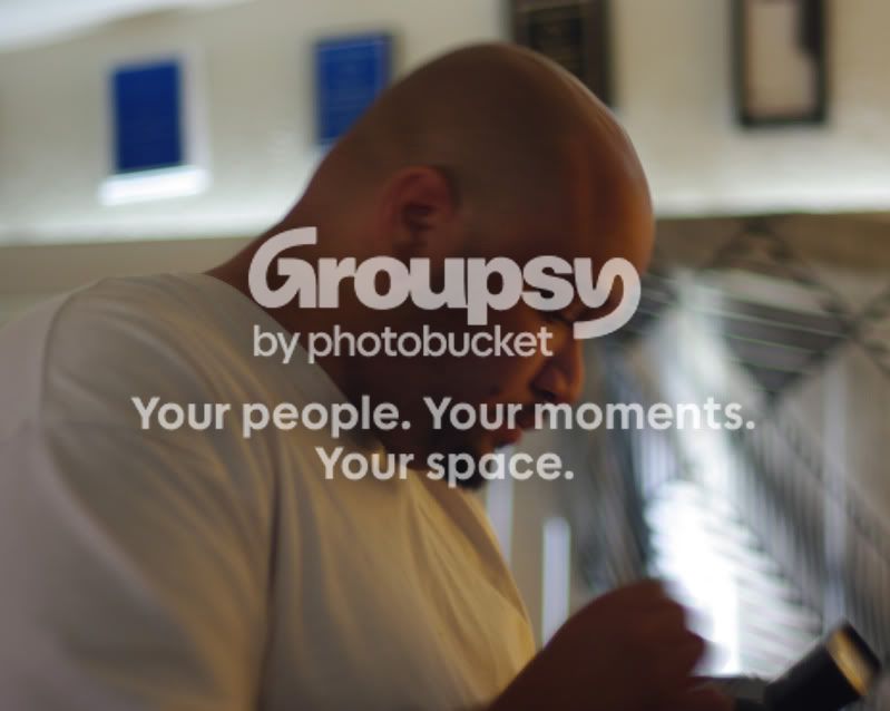

I was practicing shooting in low light today. Everything came back so blurry... Even when using the off camera flash... Humm I have the off camera flash actually on the top of the camera slot and have even tried tilting it in different directions. Absolutely NO sharp images. :( Any advice? I was told to look into getting gels for color correction, and some other things... ANy other advise. Shooting in low light is something that I would like to master. Your help is appreciated... :hug::

I had it resting on something so I don't think it was motion blur. I think that it's too dark inside.
I have a Bower SF829TW... for the flash. I put it on top of the camera usually. It really hasn't made a difference.
The camera is on auto... So yes you would think that it would automatically adjust...??
Blurry means ... incorrect focus (lighting too low for AF) or subject is moving (as opposed to camera).
At 1/3s ... any movement by the subject will cause blur.
At f/1.8 the background would be out of focus.
Use the flash to expose the subject.
Change aperture to control flash exposure ... and use shutter speed to expose the background.
Looks more like motion blur (subject moving) than camera shake (camera or shooter moving).
1/3's is pretty much out of the question for shooting people... unless they are dead.
How are you using the flash if he's holding it (if that is what he's holding)?
