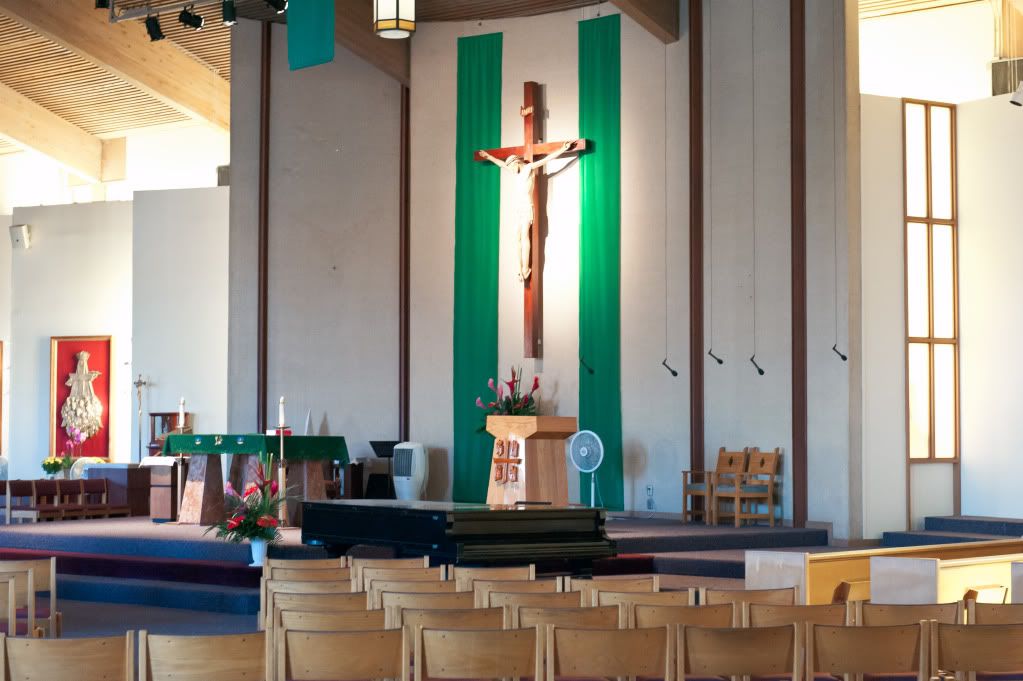

Scouted the Church out this afternoon. 5pm. Wedding will be at 1-3pm so hopefully more available light. To get the DOF I'll need with the lighting I'm sure I will need to use 6400. Spot metering on the subjects or at least center-weighted and damn the background highlights.
here's a sample taken with the available lighting high ISO. These are not posted for C&C, just to represent the low light capability of the D700 and what I am facing for lighting. I am open to any tip/tricks of the trade to take advantage of the lighting and gear I'll be shooting with. These are taken with the D700 and 24-70. I've decided I'll be using the 70-200 due to the distance from the subjects.
This is ISO 6400 pretty much out of the box
Here it is with some noise reduction in LR3 and I must admit I have not really played with those settings before.
