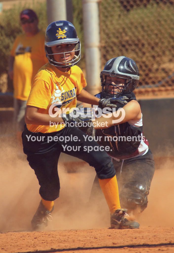

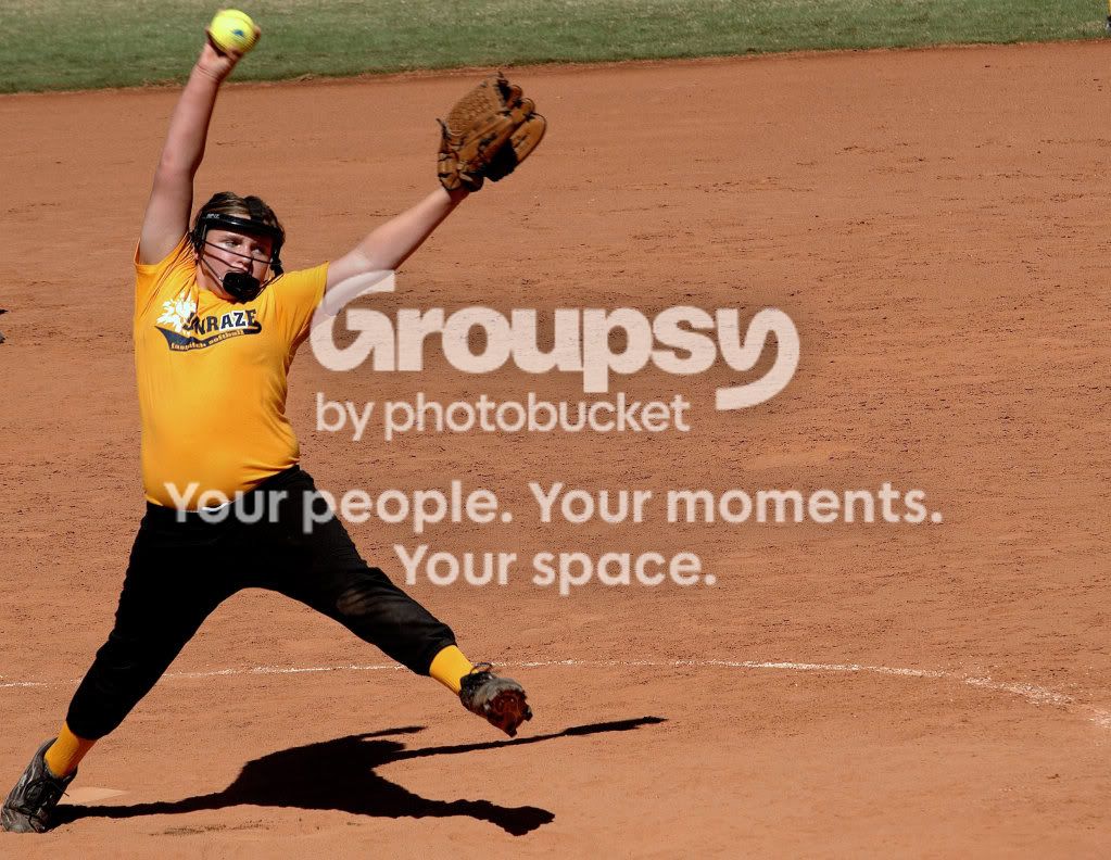

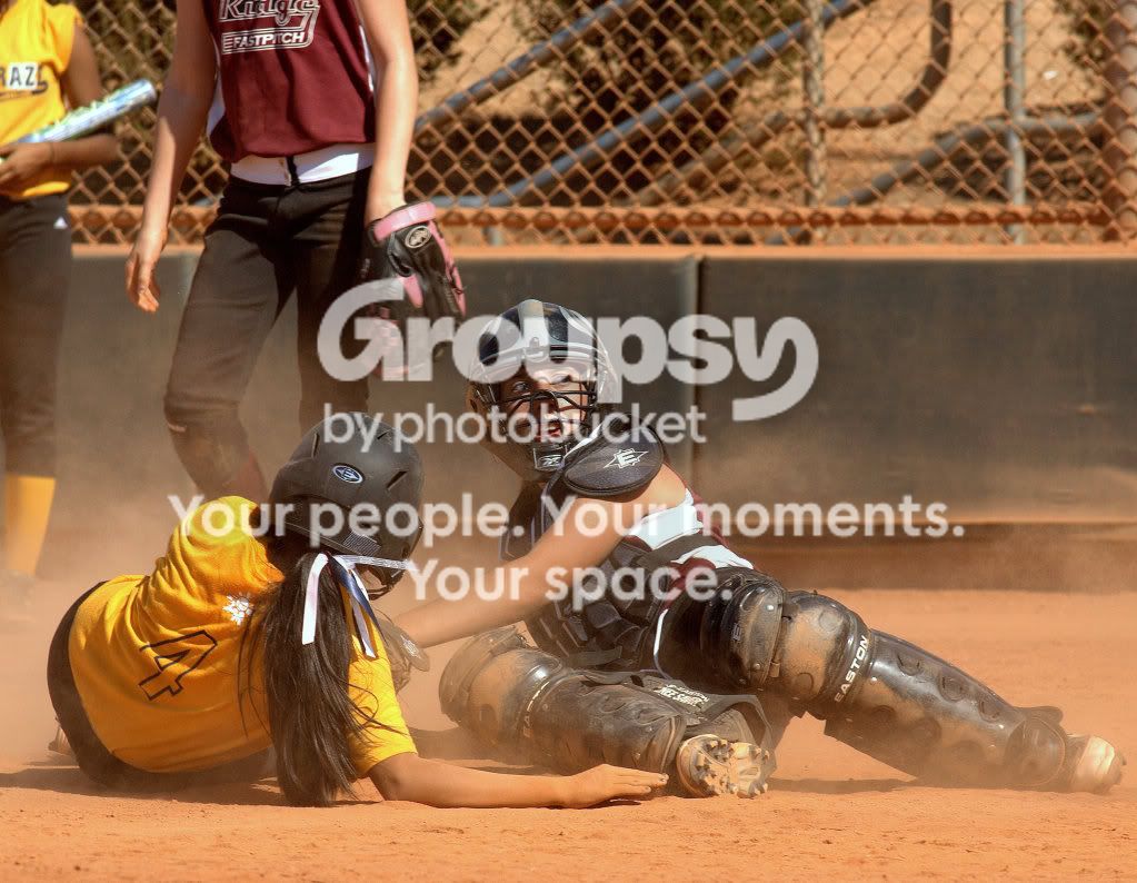

Thank you, both... I put my camera on the settings you suggested (continuous focus, spot metering and I used shutter priority). ISO was at 100 and I tried to make sure that my shutter speed did not go below 500, but I think a couple pictures were taken at below that.. Here's a few of my favorites out of over 400 pictures. I just kept shooting and prayed for the best..:D I wish the pictures were sharper. Please let me know what you think and how I can improve..Thank you!!
This is my daughter...:heart::heart::heart:
These look good. I like the first one the best.
I'm honestly surprised how good these came out. Good job.
The first one is pretty cool, the second doesn't look t0 be 100 ISO or it is cropped in too far. Pretty awesome though makes me want to go watch a game.
Thank you for the comments...I was surprised they came out like they didl! :D
They make pitchers wear face guards now? Huh. Nice pics!
It's optional... We prefer our daughter wear one now just to be safe. It only takes on line drive to knock some teeth out. When she gets older and her skills improve we'll give her the choice to wear it or not. There is a lot of controversy with wearing masks... I would rather be safe than sorry.
That must be a 'new' (within the last 8 years) thing... I was the pitcher for our team... we took state way back when, and it wasn't even talked about. It was called 'DUCK AND TURN' haha.
