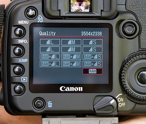

OK I am lost here ... RAW files? ... My camera the files are all Jpeg ... what are RAW files and how do you save them.
What is your camera?
Not all cameras offer the choice. A raw file is the data recorded by the sensor as recorded. A JPEG is a processed RGB photo derived from the raw sensor data. Software in the camera processes the raw sensor data to create the JPEG. Consumer model cameras typically only save the processed JPEG. Pro-level cameras offer the photographer a choice to have either or both.
Joe
OK I understand now ... I am new to Digcams, so on a very fast track of learning ... I have the new Nikon P510 at the moment and just read up that is only saves in JPEG ... When I get the Nikon DSLR that will have other options to save the photos in.
