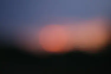

Tonight I was able to get shots that explain my problem. I was trying to shoot the setting sun at iso 5200 and I got this mess flickering in my viewfinder. Obviously one I want, but in the flickering I can’t really choose. I don’t know what to do to stabilize the image.

1R0A3526.jpeg looks out of focus. I think 1R0A3527.jpeg is behind the clouds. If you want the sun itself and assuming you are not using a telephoto lens (say, longer than 75mm), you should be able to turn off autofocus, set the focus to infinity and leave it. Beyond 75mm (and assuming an aperture of F4 or larger) you should try to manual focus it.
So what the camera is telling me is it cannot get focus. Going manual focus sounds like a good idea. I will try that on the setting sun tonight.
I was a little late for sunset tonight, but shooting in manual seemed to give a great shot, nice and clear. I also realize that I typically shoot zone AF which is causing problems trying to focus on the sky. I need to use a point AF for better AF in the situation.
AF needs an edge to get focus. Focus on the horizon, or the edge of a cloud, and then turn off AF and leave it alone.
However, if you change your zoom setting, you might need to refocus, as most modern zooms, especially "budget" lenses are not true zoom lenses, but vari-focal, meaning they don't hold focus distance as they zoom.
